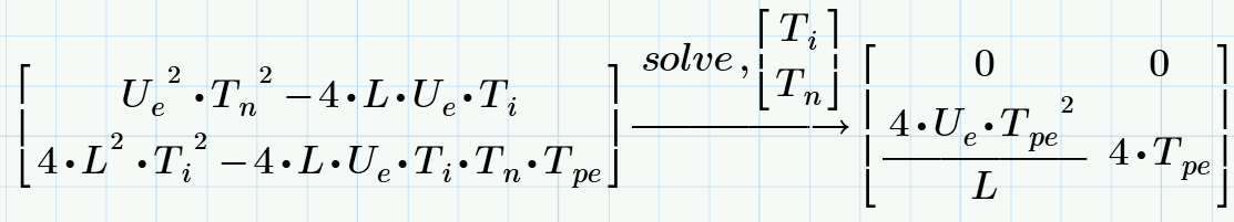

Hi there,
I'am a new user on Mathcad software and i'am getting stuck on a very simple problem, which i can solve manually, but i want to practise a bit with Mathcad.
My problem is the following, i got two symbolic functions called C1 and C2 in my worksheet, which i want to be equal to zero (each of them). My two variables are Ti and Tn. When i tried to solved those equation i got an undefined solution.
Thanks to tell me where i'am wrong.

You can reach a wider audience if you additionally provide a screenshot or pdf print of your sheet, as many of us did not bother upgrading to Prime 3.1 and so cannot read P31 files (just P30).
Werner,
PDF version of this worksheet in attachment.
May be so

Hi Valery,
Thanks a lot. Mathcad is intransigent about syntax. Are there some "books" about syntax in Mathcad ? I was looking for your solution about one hour on google without success.
Thanks again
Sébastien
