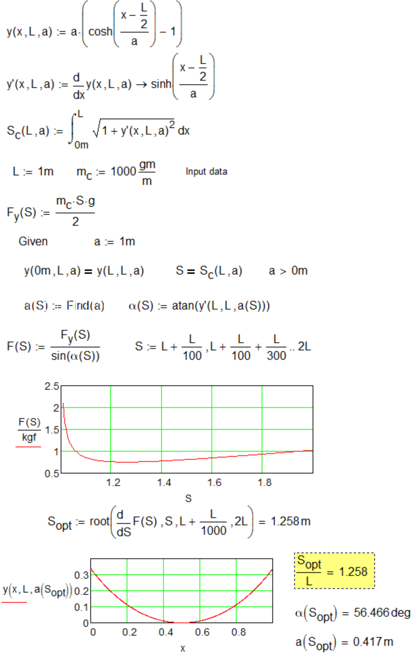

One interesting optimization problem.
Chain attached to two sides of the wall at the same height.
What should be the chain length, to force to the attachment points was minimal?
See below the numerical solution.
Is it possible to full analytical solution?

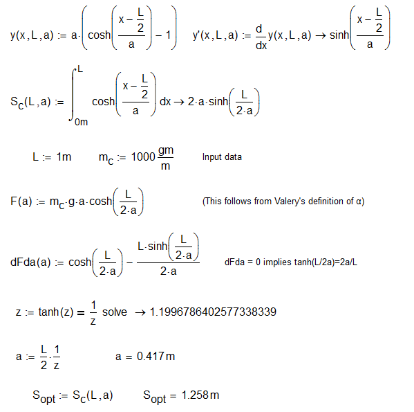

More simple numerical solution in attach (without h):

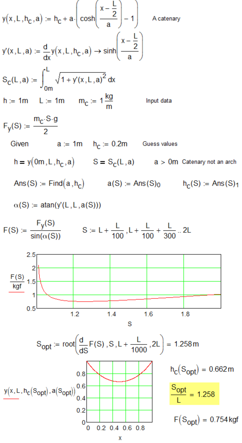

I can't see an analytical solution, but here's a simpler approach to a numerical solution:
Alan
Jul 12, 2015 4:41 PM UTC
Or even simpler:
Alan.
