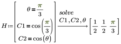

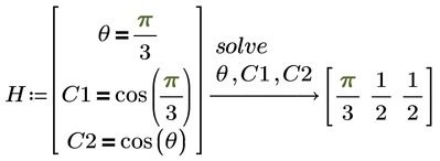

Mathcad Prime 7 symbolic solve block fails to use a solved variable as argument to built-in function.
It's common to need solve for one or more variables and then express some function of one or more variables.  E.g., two angles are solved symbolically then the sine of the sum of the two angles is sought.
MC Prime gives silly result with, apparently, any built-in function.  This is the case whether a solve variable is equated to a symbolic or a constant.
I attach an illustration using the simplest thing I can imagine:  a solve variable is equated to something (a symbolic value or a constant), then a variable is equated to a function of the first solve variable.
I offer four simple solves, each solving for an explicitly written function of the stated value and also a solve for the function of the first solve variable as the argument.
Is this inherent in MC Prime - that it can't use solve variables in a function?

I guess you found yet another bug in Primes "new" symbolics.
In Prime 6 we have the choice between the older legacy symbolic (muPad) and the new one (an Axiom fork).
Here is what the lecgacy symbolic gives:
The result of the new symbolic simply is wrong! After all, all you are doing (or trying to do) is to solve a simple system of equations with three  equations in three variables.
If you feel like doing so and think that it would help, you may consider reporting this bug to PTC.
The attached pdf shows what your sheet looks like when evaluated using the legacy symbolic (not available anymore starting with Prime 7).

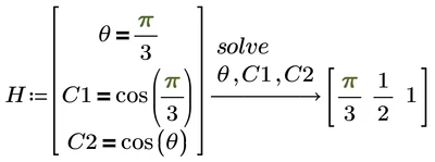

Observation: If you change the order of the variables after "solve" you get a correct result even with the new symbolics:
