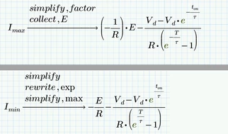

It would be hard to impossible to make the results looking the very same. We have not much ways to affect the way the symbolics displays its results.
Below you see the best I could achieve (see also attached Prime 5 worksheet)

No, the answer you get from Prime is equivalent to the one in your books, but just quite differently looking.
The symbolic solve will yield a 1 x 2 vector and it may be hard to see where the expression for the first variable ends and the one for the second begins.
So its best to assign the result of the solve command to a 1 x 2 vector of variables and let these display one by one.
BTW, you have inserted a solve block and inside the solve block you used the symbolic solve command. You don't need a solve block. Solve blocks in Prime are for numeric calculations only.
The attached commented worksheet should give you an idea how difficult is may be to get the symbolics to do what you want. Its just a matter of trial and error and a lot of frustration. handling symbolic results sure should be easier and more straightforward.
