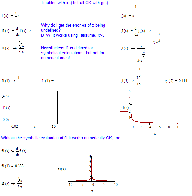

Symbolical derivative - is it a bug?
Is it a bug or is there any reasonable explanation for this effect?
I am aware of the different ways that third root of x and x^(1/3) are implemented for negative arguments
and those negative values sure are the reason for the error because all works OK when I "assume, x>0". Nevertheless I don't clearly see a reason why the symbolical evaluation after der derivative should make the numerics fail.

Here is what Mathcad 11 makes of it:
I guess it's a bug.
Potentially caused by, or related to the feature that roots are shown as roots (instead of as powers) since Mupad is the symbolic engine, and that I was very jealous about
until today.

> I guess it's a bug.
Yes, probably kind of.
From the plots it looks that in MC11 also the numeric evaluation of the third root of -1 yields a non-real result and so nothing is plotted for negative abscissa values.
So obviously the distinction between third root and ^(1/3) was introduced later because people complained about the third root of a negative number not being a negative real. I am not sure if it has something to do with muPad - numeric evaluation treats root and exponentiation differently, too.
