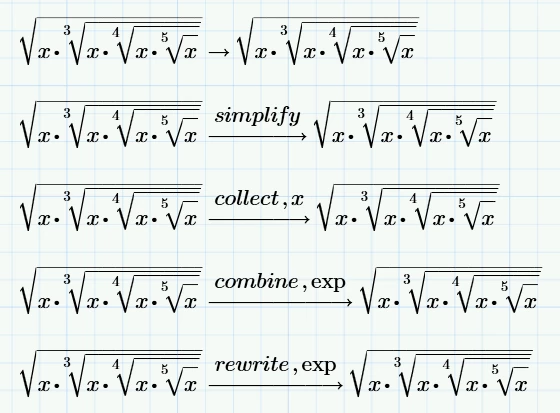

Greetings friends of the forum.
I have the following query: I need to symbolically simplify the following function.
Using the following operators that I know of, I do not get a simplified answer:

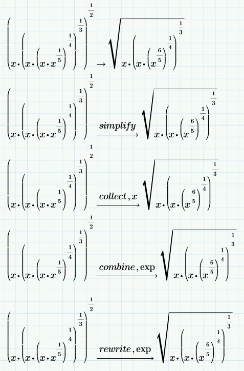

Writing the function exponentially, I also do not get a correct answer:

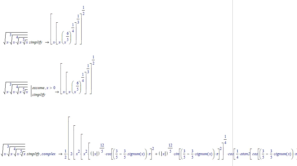

Best answer by LucMeekes
First realize that it is hard to control the output of the symbolic processor of Mathcad (and Prime) exactly to one's desire.
Here's my result in Mathcad 11 (with Maple)....Not so easy, maybe you have more luck in Prime when you assume that x > 0:
Note that the last result is not complete. I chopped off several pages of the width!
LucMeekes23-Emerald IVAnswer
July 21, 2018
rhanet1-VisitorAuthor
July 21, 2018
Thanks for your solution Luc. Working with Mathcad Prime I get what I was looking for:
