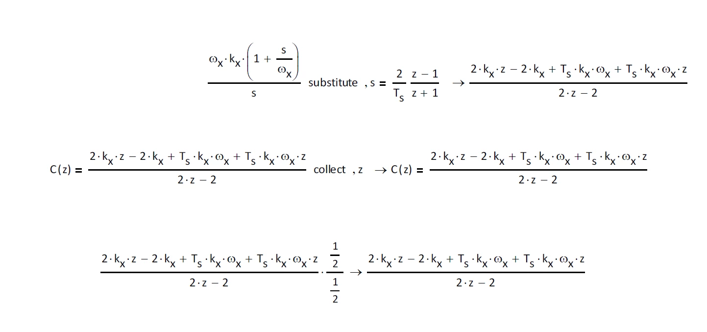

Hello, I am trying to manipulate some equations into a desired form, specifically in the s domain, into a 'bode' form, and similarly in the z domain.
I am having no success, to the extent that I am struggling in the case of the latter to group terms by the z variable, let alone getting in terms of z^-1.  Here's what I am working with at present:
As a first step I'd like to get numerator as a poly in z.  A second step is getting into a format of z^-n (n integer), and finally the denominator as (1 - poly in z^-n) also:
Have spent some time trying to manually manipulate the equation to no avail.  Any step wise instructions would be greatly appreciated.
Am using v15 (15.0 (M005 [MC15_M005_20101105]))

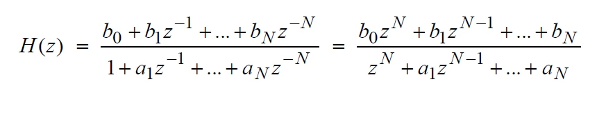

Example textbook forms of a discrete filter is one of either:

It is well known that it is very hard to control the output of Mathcad's symbolic processor. If collect and factor don't provide the results you want, what you can do is manipulate parts of your equation, if necessary by hand, and check you results by subtracting it from the original equation. Though even that sometimes fails.

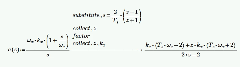

You have an 'equals' (bold 😃 in your expression, which means that the result of c(z)=2*k.x+...etc is either True (1) or False (0), also for the symbolic processor. It also causes it not to collect the z terms.
Better use the definition operator ':' (which shows as ':=') and do like this:

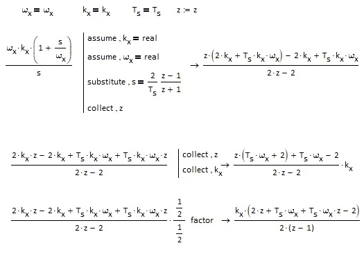

-MFra-
Hi Jack,

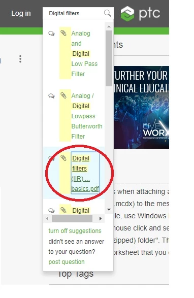

you can find an extensive discussion of the topic with countless examples built with Mathcad 14-15, by doing a search here:

23-Emerald I
