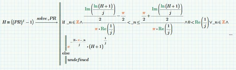

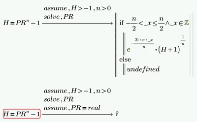

Using symbolics (4.0) to develop an algebraic solution - but I get more than I bargained for.
I can't seem to find an assume or other feature to simplify this.  I'm assuming I need to specify real solutions or similar but that doesn't seem to work.  What I'm expecting to see is:
Any ideas?

I assume that j should NOT denote the imaginary unit, right?
Here is my best attempt - I had no luck in persuading Prime to return only the real solution (the one with _x=0)

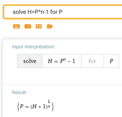

Still disappointing when we expect something more simple like this
