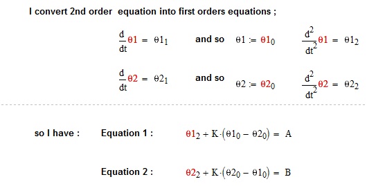

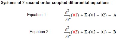

My problem deals with a system of 2 second order coupled differential equations, Using Mathcad.
I issue a problem with the "D" function (used to solve a differential equation) when there is more than 1 parameter inside.
Here is the system with 2 parameters Teta1 and Teta2 :
I convert this system to have only first order equations :

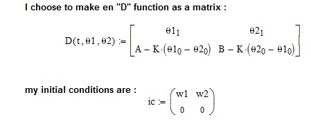

Then, I can't find other way than making a D matrix with my 2 parameters Teta1 and Teta2

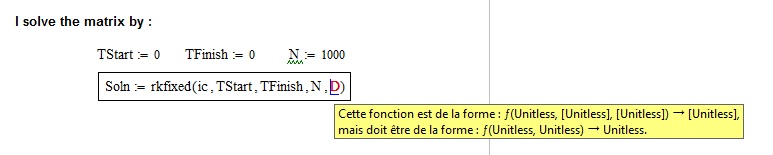

Then, I issue my problem : its seems that I can't put a D function with 2 parameters in rkfixed method.
So, if anybody here can find a way to solve this system, please let me know ! Any other method to solve it is welcome, of course !

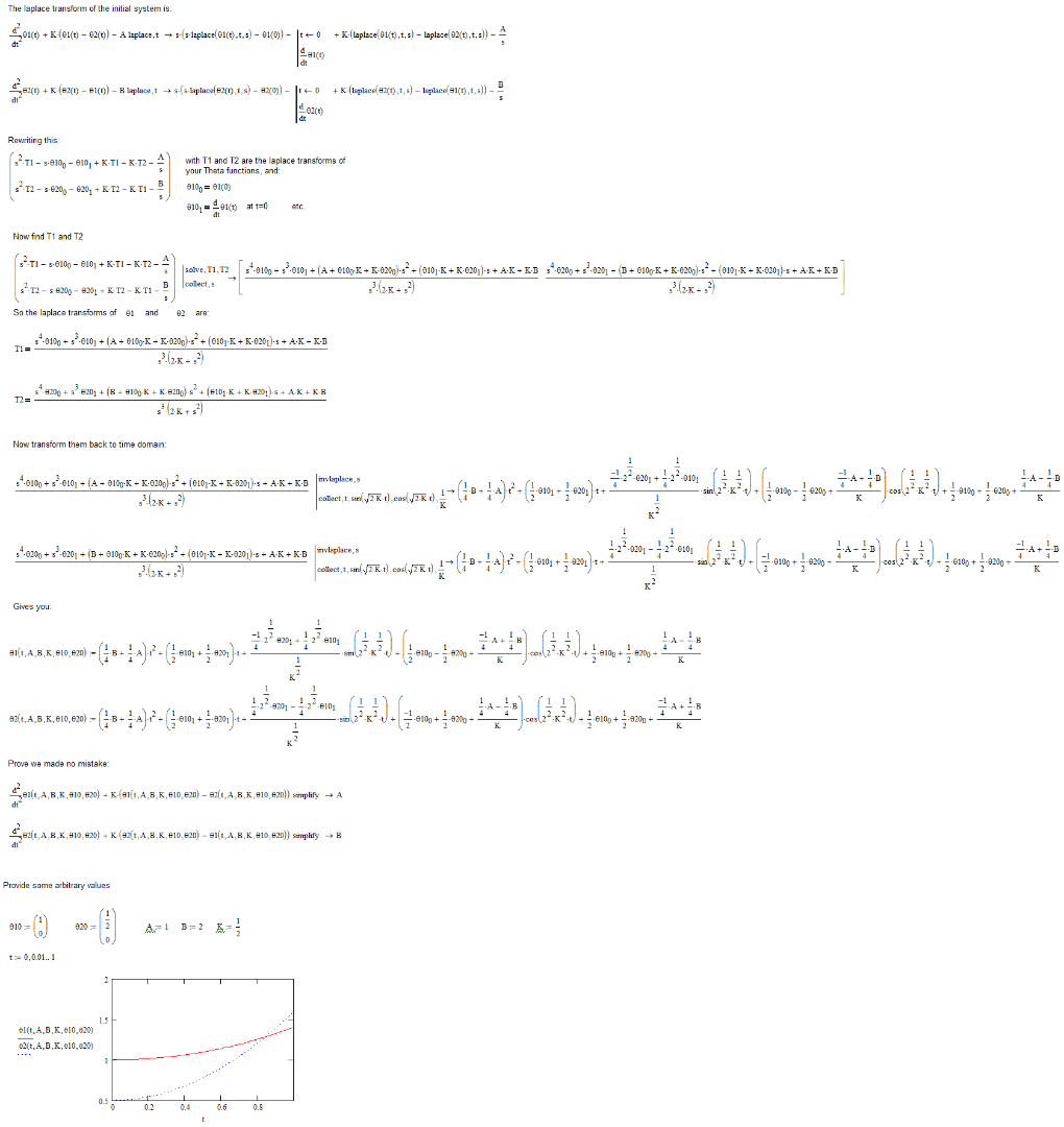

How about this:
This all to show that Mathcad is much more powerfull than doing just numerical solutions.
Your D function has three parameters, not two. The variable t does not even appear on he RHS, so get rid if it. If that doesn't fix it, please post a worksheet. It's hard to debug a picture.

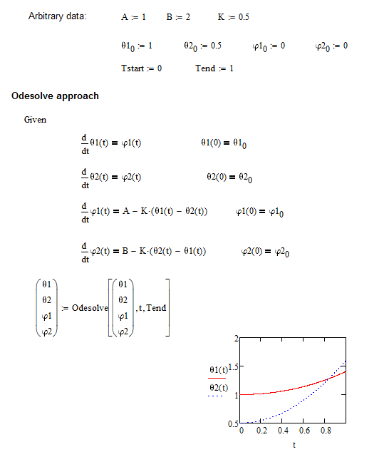

Here are a couple of methods:
Alan

The Mathcad 14/15 ODE solvers do not accept a 2D matrix form for the differential equation.  Instead you must recast it as combined vector.
