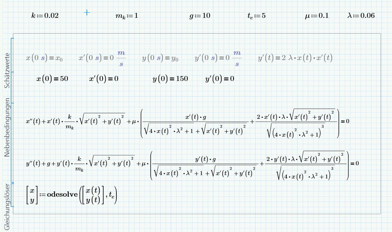

I only saw the pdf-file, perhaps I miss something, but I see 2 ode`s second order. You need 4 boundary conditions (bc`s) to solve them.  But I see 5 bc`s.
Best wishes
Stephan
vlehner1-VisitorAuthor
Hi Stephan,
I have two differential Equations second order with four BC's.
regards, Volker

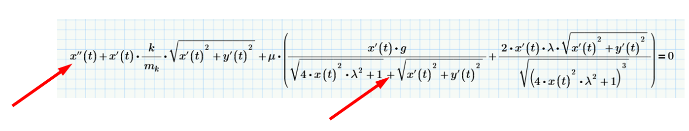

Ok, I put some time in the worksheet.
I changed some points and got a solution:
First: I delete every units. (normally it should work with units, it seems there is a mistake in the formulas)
Second: I changed the term x(t)'' in x''(t), see picture below (first arrow).
Third: I changed ("*") into ("+") (second arrow in both ODEs). This is perhaps physically wrong, but there seems to be something wrong in your formula as well, otherwise it should work.
You can see my full changes below. Especially Point 1 und Point 3 are signs for a mistake in the formula, but i am too far away from that topic to see what's wrong.
I hope that will help.
Hi Stephan,
could you please post the File where you made your changes ?
What graphs did you get and can you imagine that the graphs should be a damped vibration because of friction and air-resistance?
you should take the latest sheets-not the one of the beginning of the threat.
THX, Volker
