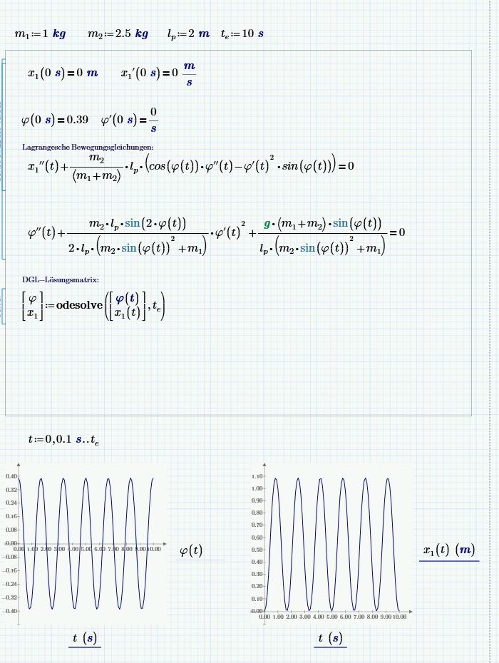

Hi Volker,
what do you think about my solution shown in the following picture?

Hi Volker,

Hi!
Wow, you got a solution.
you replaced x''(t) from the first Equation into the second Equation-and it works- can't belive it.
Why does MathCad don't accept my first solution?
Thank you!!!

Hi Volker,
Perhaps to define two times the second derivative of the same function, it creates difficulties.
since the argument I always liked (Lagrange equations) could you give me a sketch of the mechanical system (which seems like a pendulum, or something like that)?
