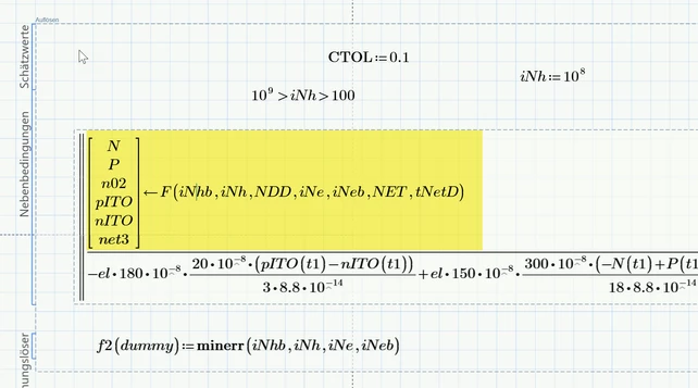

Hello, everyone. I wrote a simple program that solves 5 differential equations. Further, I fit experimental data with MINERR.
It works but it works very slow.  Does anyone know how to do it a bit faster?
Thank you in advance! Program is attached

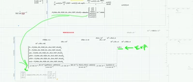

Your minerr-solveblock calls the odesolve-solve block (function F) six times for every iteration, which is quite inefficient.
The modification seen in the pic below should speed up the calculation by the factor 6.
I turned the solve block into a function just to be able to determine and compare the execution time of both versions.

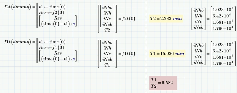

December 28, 2020
I just finished timing the two versions and the speed gain with my suggested modification is indeed a little bit more than factor 6.
P6 sheet (with auto-calc disabled) attached
