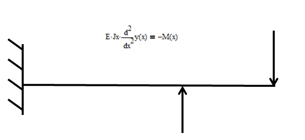

how can I solve a system of ordinary differential equation (with relative boundary condition) in mathcad 15?
I must determined an elastic linear equation for a beam fixed to an extremity and with to transverse force applied in different point.

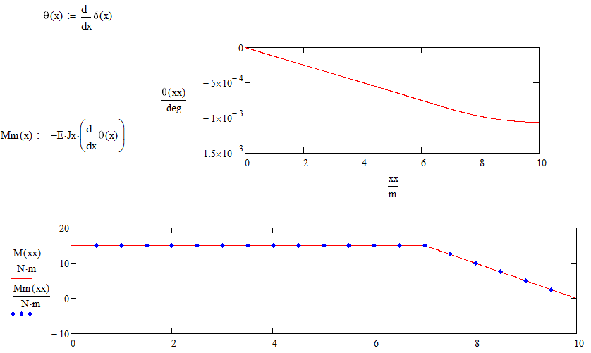

A cantilever beam is a simple problem:

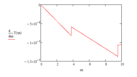

and how can I obtain the graph of rotation of sections dy(x)/dx? I try to differentiate the expression but I obtain a wrong distributionCattura.PNG

Right-click on Odesolve(x,Len), and choose "fixed" instead of "Adams/BDF", then:
Quirks of numeric solvers!
