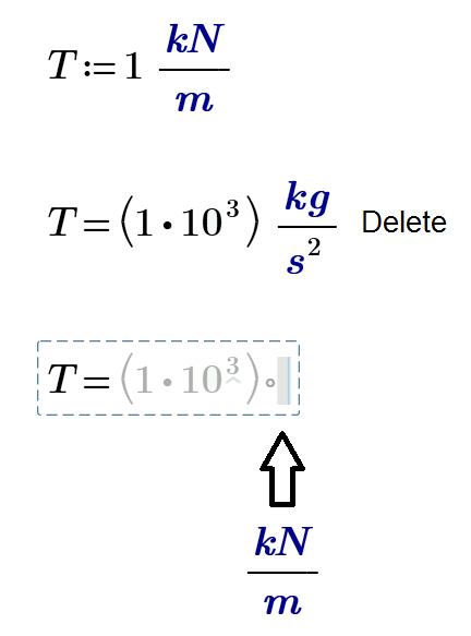

Please see the screenshot below. PAEH's unit should be kN/m.
Vincent
kg/s^2 = 10^-3 kN/m
So simply replace/overwrite the units suggested by Prime by the units you want to see.
