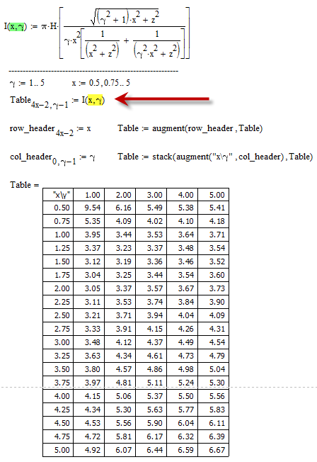

I have a fairly complex formula for I(q,x) and I want to tabulate the results with q values (1 - 5) as the columns and x values (1 to 5) as the rows. I've no doubt it's very easy, but I can't see how to do it.

Thanks for prompt response. Here is the output table from Excel. I have to show that Mathcad gives the same numbers. x in my original message is B in the Excel sheet.
Maybe something like the two approaches attached?
If the values for x and/or q are not in ascending order with step size 1, different approaches are necessary. If thats an issue, ask again. Also, if you would like to have rudimentary row and column headers.
August 12, 2014
Thank you very much. These are simple enough even for little me to understand. I probably only need to do this once, so no refinement is really necessary.

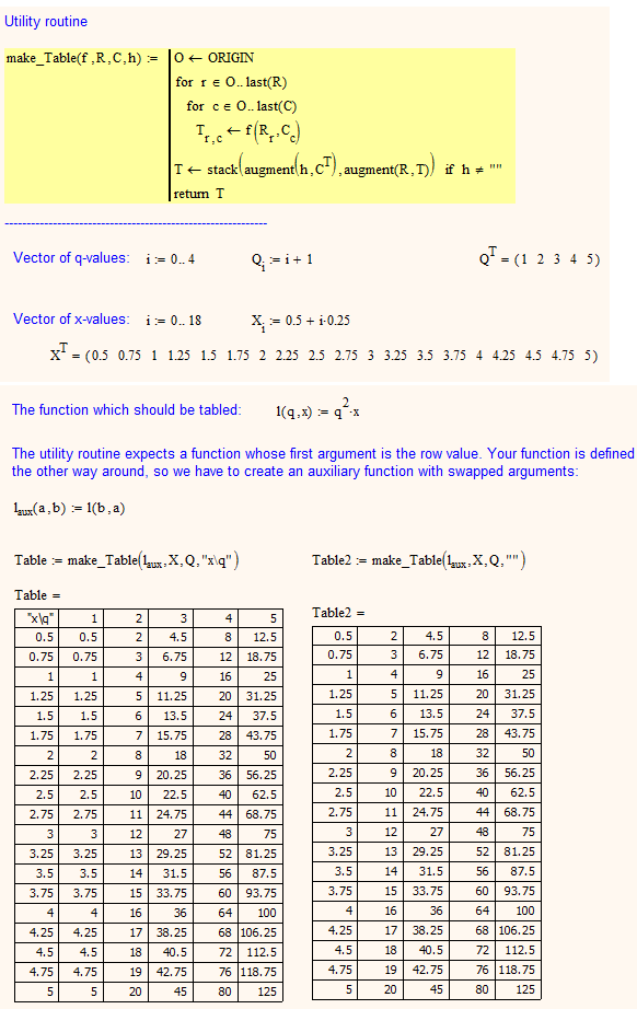

As explained above here is a more general approach by defining a utility routine and providing the row and column values as vectors. The function is assumed to have two independend arguments and the table created would have the first argmuent for the rows and the second for the columns. As your function seems to be defined the other way round, you will have to create am auxiliary function.
I am not including the worksheet as we still don't know which version of the program you are actually using.

This, too, is not too difficult for me, but maybe more than I require. I'm using Mathcad 15 at present. Thank you very much.
How can I retrieve your worksheet/ I can screen-grab, of course, but I wonder f there is a better way.
August 12, 2014
Retrieving the sheet is easy - you simply ask for it.
Here you are!
