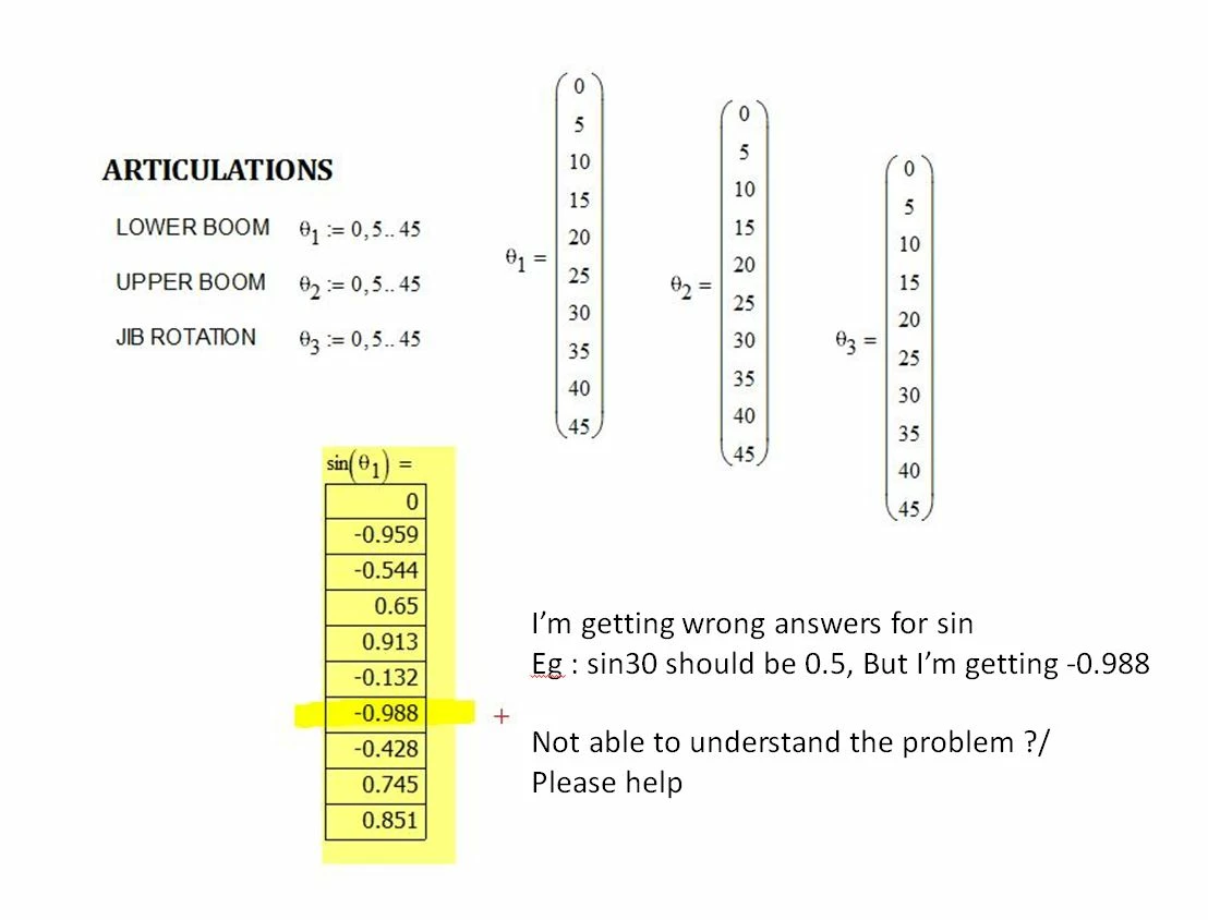

Dear all,
I'm just new,exploring mathcad.
I'm trying to do some simplae calculationns.
Please see attached and help me.
RaikoAnswer
May 27, 2013

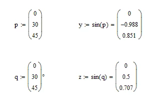

Hello Dinesh,
your problem is a simple one: you forgot the units (degrees in your case). Add them to the matrices and you'll get the proper resul; see image.
Raiko

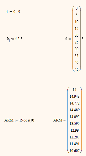

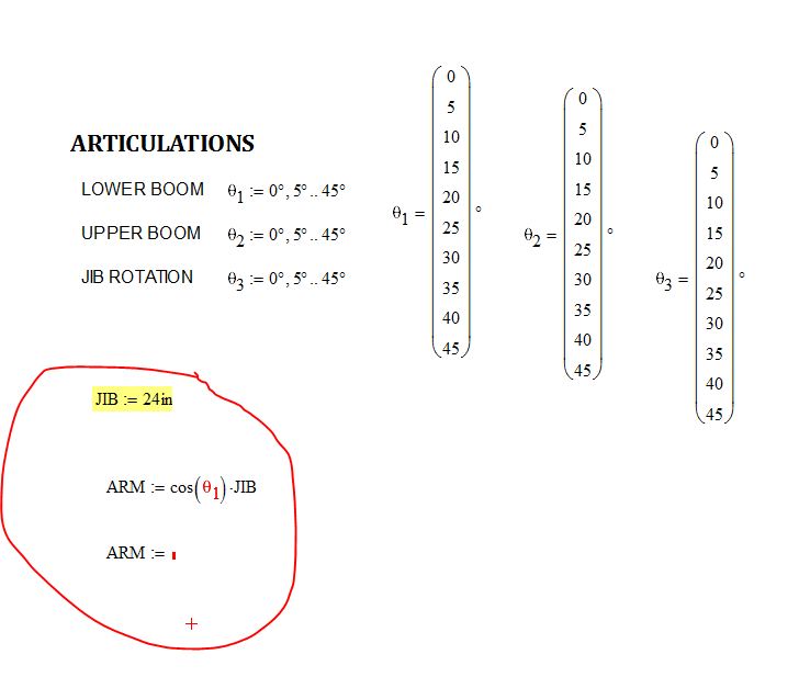

May 27, 2013
Thanks a lot Raiko, I have another question to go with, looking for your answers
continuing with similar example,I'm trying to relate a formula to it.I'm not getting.
Any help please. I know it's a silly mistake,but still looking forward your help
May 27, 2013
You are confusing range variables with vectors! A common mistake as they may look alike but aren't. Range variables are sort of an implicit for-loop and should be used for indexing matrices/vectors, for plotting and in programmed loops only.
Make your angles true vectors and it will work.
For future questions: Please attach your worksheet!
