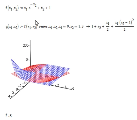

But you may do it using scalar arguments with literal indices:
f is showing in blue, the approximation g in red.

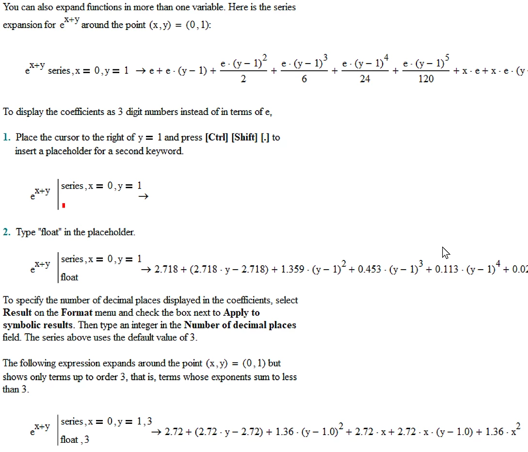

BTW, if you use real Mathcad (current: version 15) you find the information you need in the Quicksheet "Symbolic Calculus".
If you use Prime, the help is much more limited and cumbersome - I am not sure if you can find the information there. I attach a screenshot of the Mathcad help.

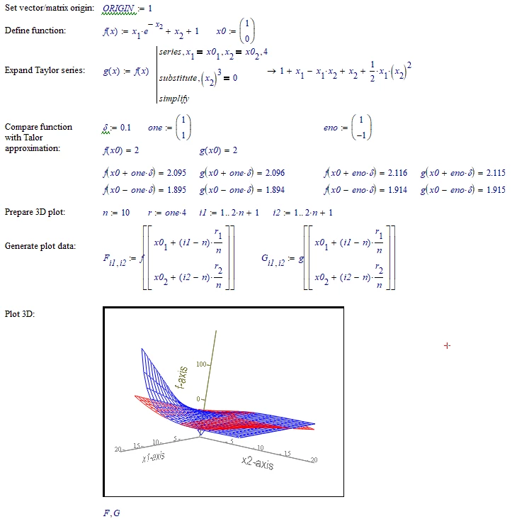

September 8, 2019
Addendum:
You can define the function using a vector argument and vector indices, but when it comes to the series expansion, you must (unfortunately) use literal subscripts.
In case you are voluntarily using Prime, here is the sheet in P5 format attached.

This is what I get in Mathcad 11:
