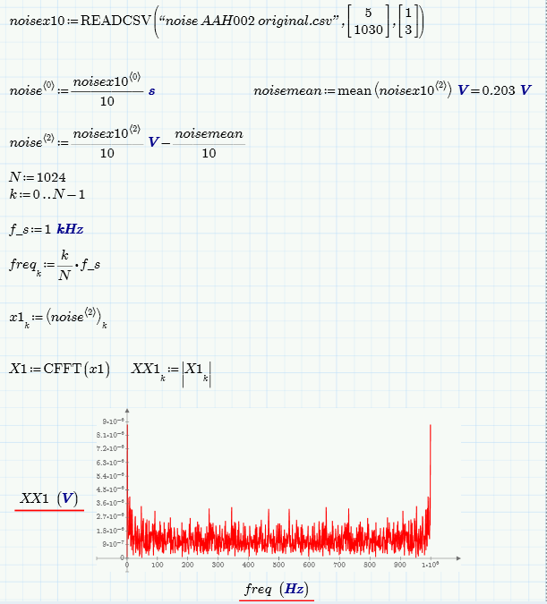

Ok, I finally got the graph working.
How do I get a logarithmic scale on the X axis?
Here is a screen shot. The CSV is too big to post it here.
January 24, 2013
Click on the x-axis to select it.
Go to the "Plot" tab. Click on the "Logarithmic Scaling" button.
Also, note that your graph is mirror symmetric about the 500 Hz point. This is an artifact of the FFT process. You should limit the graphed data to 500 Hz.
