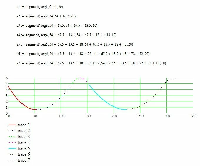

Here is the parabolic answer.
It is a Mathcad 15 file as I do not have full Prime 9 only express and programming is not available in express.
You can convert the file to Prime 9 full with the converter.
The circle shapes can be approached in a similar manner.

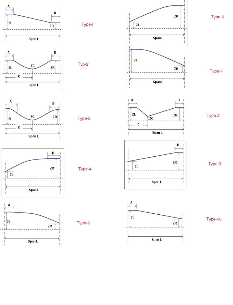

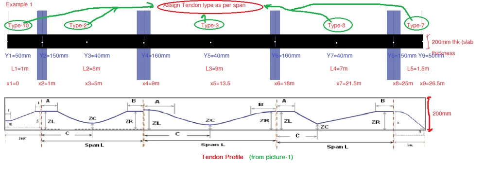

hi @terryhendicott  and all
This problem is same as I posted in this community.
its general idea of my problem
1. first pic is tendon profile. I think we can do it as functions then
2. Second picture show we apply tendon per span.
3. Purpose: plot the tendon profile (X, Y) and use in future purpose
Thank you in advance
Mar 27, 2024 6:41 AM UTC
Typical Tendon Profile per spanTypical Tendon Profile per spanAssign or Apply Tendon Profile to any span and ExampleAssign or Apply Tendon Profile to any span and Example

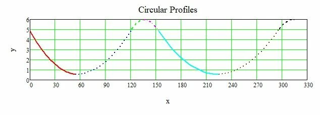

For completeness here is the circular profiles,
Again a Mathcad 15 file you will need to convert to Prime 9.
The seven steps could easily be put into a program with a 7x7 matrix input of values to the seven calls of circ_m() function.
To eliminate input for the intermediate slopes you cannot use a 21x21 matrix method like the parabolic curves.
You would need to create a 21 equation solve block.
Cheers
Terry
