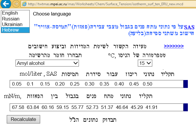

I insert different pictures as a text by the changing of languages on my Mathcad server.
One example.
http://twtmas.mpei.ac.ru/mas/Worksheets/Chem/Surface_Tension/isotherm_surf_ten_ERU_new.mcd
And I do it when I want to have comments - all is ok or not ok - with colors
