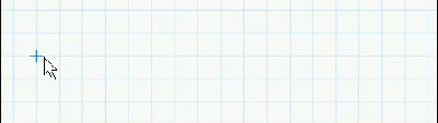

PTC Mathcad Prime 9 math to text regionPTC Mathcad Prime 9 math to text region
Here's a preview I just recorded of the math to text region feature in (the imminent and upcoming) PTC Mathcad Prime 9, activated with spacebar.
