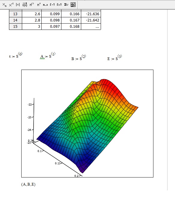

For the following mathcad code which I attached here
the 3D plot is not visible in my mathcad window.
In the 3D plot region, I also uncheck the "border" by right clicking the 3D plot region
but the 3D plot is not visible.
If I copy the 3D plot figure from mathcad window to powerpoint
the 3D plot is visible.
I am using  laptop with windows 7 OS.
Could you please tell me how to make 3D plot visible in mathcad window and
could you please tell me what is the problem?

Hi vetri veeran,
On my pc it is visible (windows 10). I suppose you have a problem with your computer.
