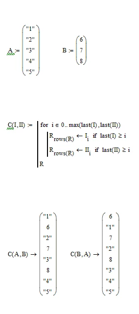

20-Turquoise
Feb 13, 2023 4:41 PM UTC
It seems like this :
Best Regards.
   Loi.
lvl10720-TurquoiseAnswer
20-Turquoise
Feb 14, 2023 12:37 AM UTC
   Best Regards.
Feb 14, 2023 2:26 AM UTC
I guess this is just my second appraoch with differently named variables and without being ORIGIN-independent and without error checking, right? 😉

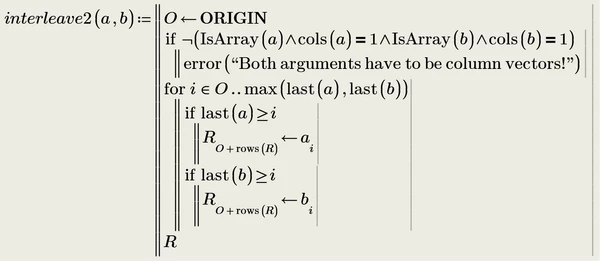

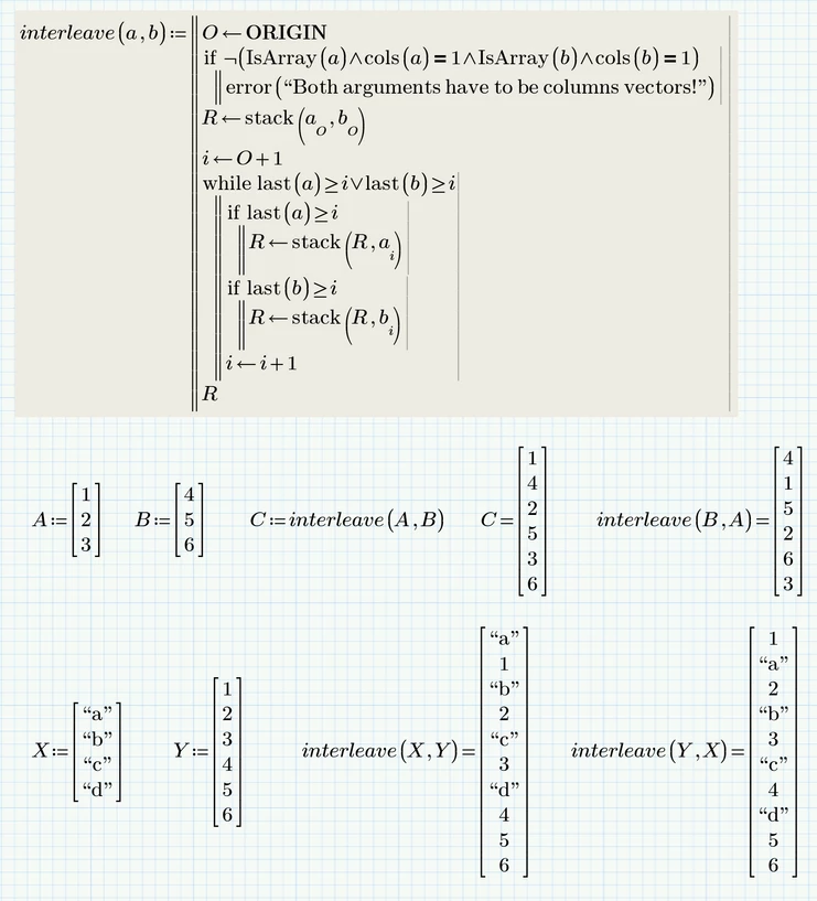

Here is a generic utility function which interleaves two vectors of arbitrary lengths. They do not necessarily have to be the same length.
File in Prime 6 format attached
EDIT: Added a slighter shorter variant
Feb 13, 2023 8:45 PM UTC
This isn't better than the others already posted, just different.
Or a small variation:
