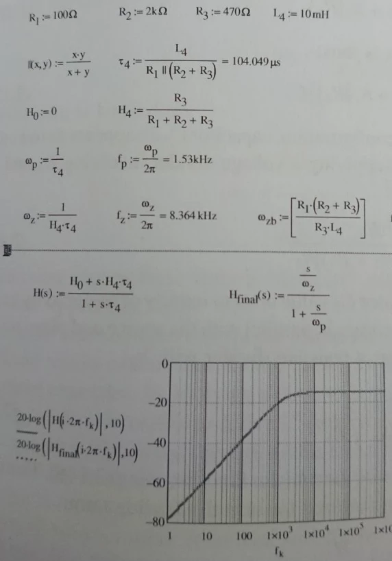

Can we use the infix notation for a function name in Prime?
For Example, I want to create a function for parallel resistors
and use it for the circuit element by typing R1 || R2  for example. It was possible in Mathcad 15.
Attached the sample from Mathcad 15.

Thanks, but I mean to write in classical electrical symbol form. Like here (Mathcad 15)
Not ||(R1,(R2+R3))  but  R1 || (R2+R3)
