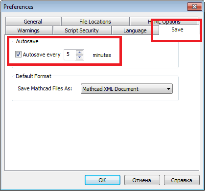

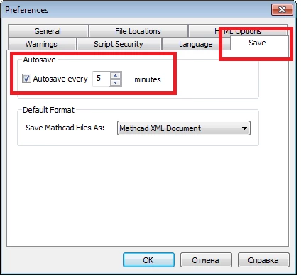

For the future - you can use a built-in "Autosave" option of the working document (in main menu select "Tools" --> "Preferences" --> "Save"):
