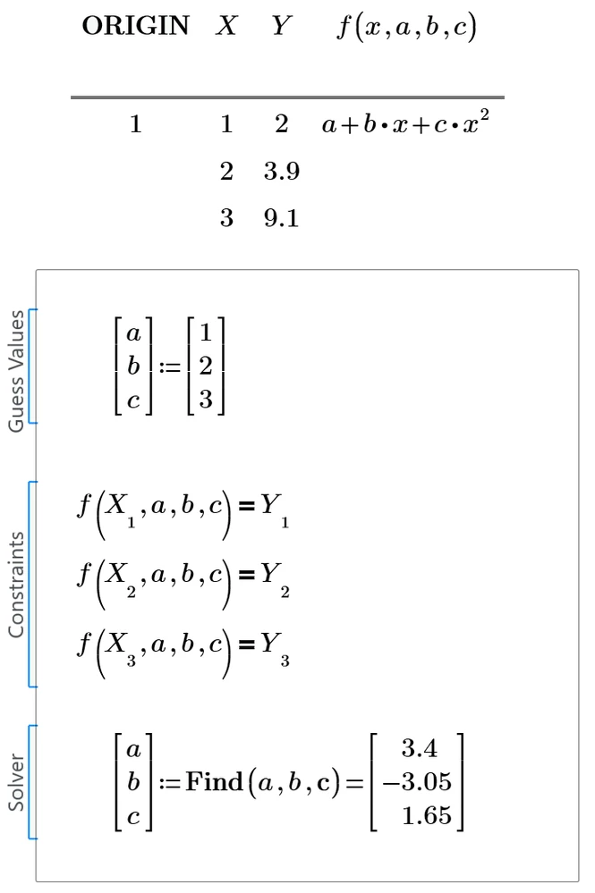

The root of extrapolation. Do yo have one more usefull example?

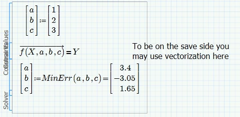

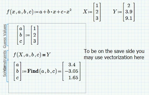

1) Why do you forumulate your solveblock so complicated? You may use the full vectors instead:
2) If your goal is a fit, a regression, you would rather use MinErr instead of Find:

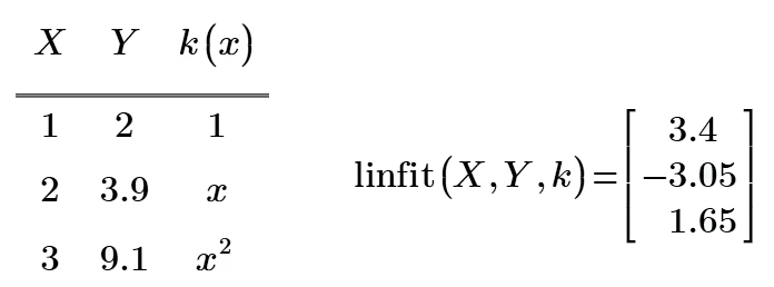

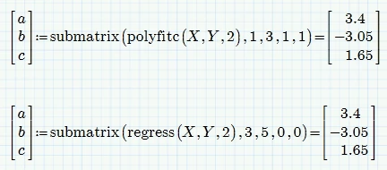

3) What you have done with the solve block can be done more efficiently using polyfit(s) or regress
4) In case one day you dont are after a polynomial fit, you would rather user genfit:
