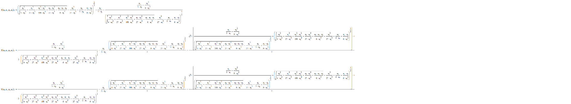

Hi all,
I am getting an error as symbolic result returned is too
large to display.
Here, I want to compute cubic polynomial.
can anyone help me to rectify my error
and plot the real and imaginary values.
I mentioned everything clearly in my code.
I attached the code below.
Thanks.

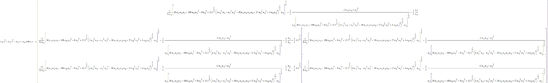

The result is too big to handle for Mathcad 15, because it's:
As Fred, and the error message, indicate, you can still use it:
23-Emerald V
May 2, 2016
And if you really, really want it, you can see the three symbolic results separately in Mathcad 15 using:
to get:
