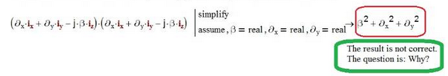

The usual problem with the imaginary unit.
Hello everyone,
What can I do to prevent this?
in order to have a result, I had to consider the operators as variables.
Thank you for all.
F. M.

This ist the first time in the sheet you show where you are using complex entries and so its the first time you experience the difference between conjugate or not.
I am not willing to retype but I guess you would get the result you expect if you use one of the two methods I showed above (transpose the first factor OR conjugate the second).

I am not sure why you think that Mathcad is doing anything wrong.
It correctly complies with the definition of the dot product of vectors with complex entries:
See here, for instance: -> Dot product - Wikipedia, the free encyclopedia
To get what you obviously want to see, you would either have to use the matrix product (multiply a 1x3 row vector with a 3x1 column vector) or use the conjugate of the second vector of the dot matrix produkt:
So for your first "wrong" example:
Sorry, but I don't understand what you mean by that!?
