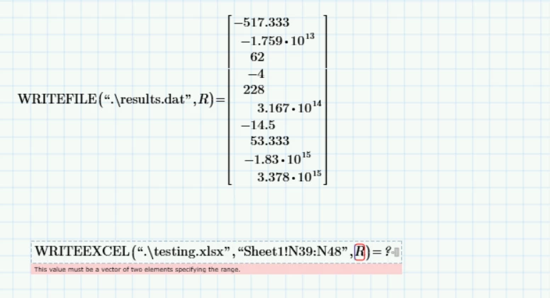

The value must be a vector of two elements
I am unable to use the writexcel function in prime. I am not getting what is missing in here
VladimirNAnswer
May 26, 2022 12:27 PM UTC
May 25, 2022 6:31 PM UTC
Look up the WRITEEXCEL function in the help.
You have to exchange the second and third function argument!
And for your next question - its always better to attach the worksheet itself and not just a picture.
