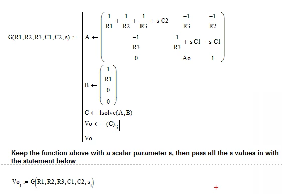

The value must be an integer
I tried to make a WCCA for an AC circuit, but I into in some problem.
I get an error: The value must be an integer ... and I cannot solve this issue.
I am attaching a Mathcad file with this problem.
Can you help me?
Thank you.
    See attached file
    Alan
    See attached file
    Alan
