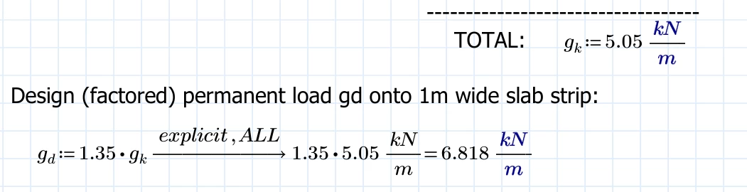

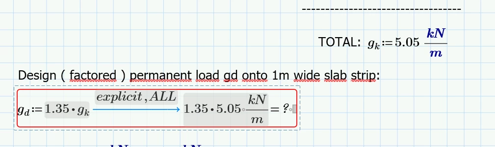

The variable is undefined. Check that the label is set correctly
I can not find the result. Example11 is my sheet it should be like in the file example22.

Can you enclose the worksheet.
Question why use symbolics?
Cheers

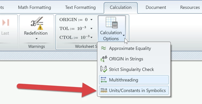

Maybe it helps to turn on units/constants in symbolics and let the sheet recalculate.
Otherwise I second what Terry had said - post the worksheets, not just pictures.
