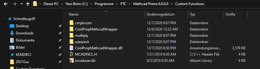

Even though I have copied CoolPropMathcadWrapper.dll file to C:\Program Files\PTC\Mathcad Prime 3.1\Custom Functions, I still cannot reach any functions of the dll.

Well, you're in luck.  I wrote that add-in wrapper for CoolProp and just happened to be on the forum today.  For future reference CoolProp issues are posted on GitHub and there is a CoolProp Google Group for general usage questions. However, I can try to help you here.
CoolProp Version 6.4.0 is working here on Mathcad Prime 6.0.0.0 on my Windows 10 machine:
Which version of CoolProp did you download from SourceForge?
Which version of Windows are you running?
A few (really) obvious things I have to ask:
  • Mathcad has to be restarted if you just copied the DLLs.  It loads them on start-up only.
  • If the file was previously saved with the error, hit F5 to recalculate that function.
  • Mathcad Express does not (I believe) read in add-in DLLs.
Let me know.

I have solved my problem and want to let you all know.
I rebooted my computer and then I installed Mathcad Prime v.6.0.0.0 again on it. Everything is working flawlessly right now. I think the reason why I had the error is changing the language of my OS.
Normally I was using the English version of Windows and then I changed the language to German. I had a similar problem with the "ADAMS" programme, provided by MSC, also and at the moment it is working well, too.
