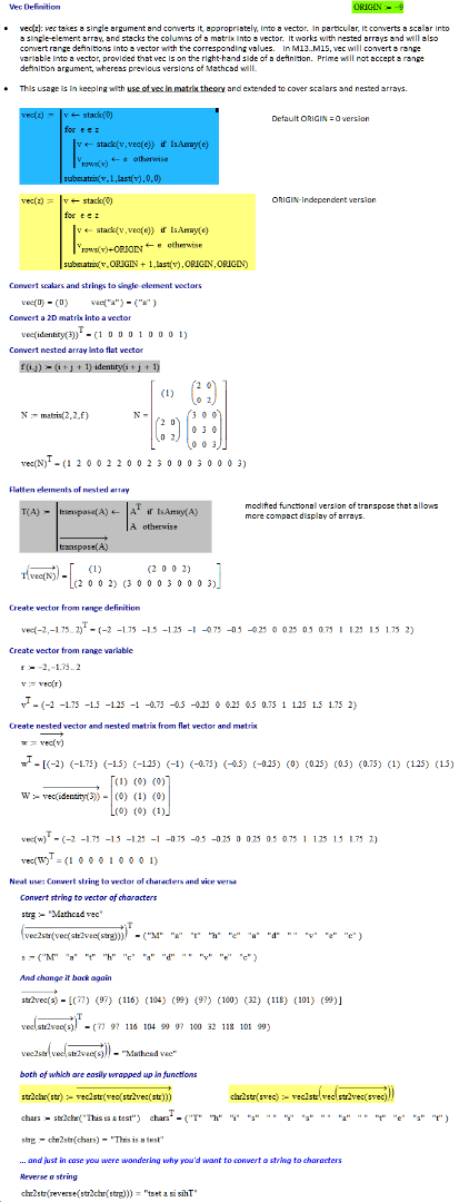

Following on from the thread Prime 3.1: Method for converting range variable to vector no longer works!, I thought an updated, ORIGIN-independent version of my vec function might be of some interest.
The vec function converts its arguments into a vector, including nested arrays of arbitrary depth.   See Vectorization (mathematics) - Wikipedia, the free encyclopedia for further information on the vec function in linear algebrae
Apart from Prime's (<= v3.1) inability to accept a range definition as an argument, vec works in Mathcad 15 and Prime 3.1.

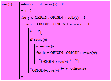

One problem with the above form of the vec function is that it doesn't work with symbolics; the particular form of for loop (e is element-of array) isn't supported.  Here's a version that will work with the symbolic processor.  As usual there is a trade-off and in this case it's that vec no longer. converts range arguments into vectors (which I find of greater general utility)

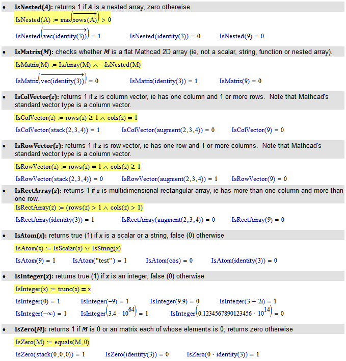

The still-outstanding major predicate omission is IsNested .... I'm sure that a built-in function must be more efficient than my library function.

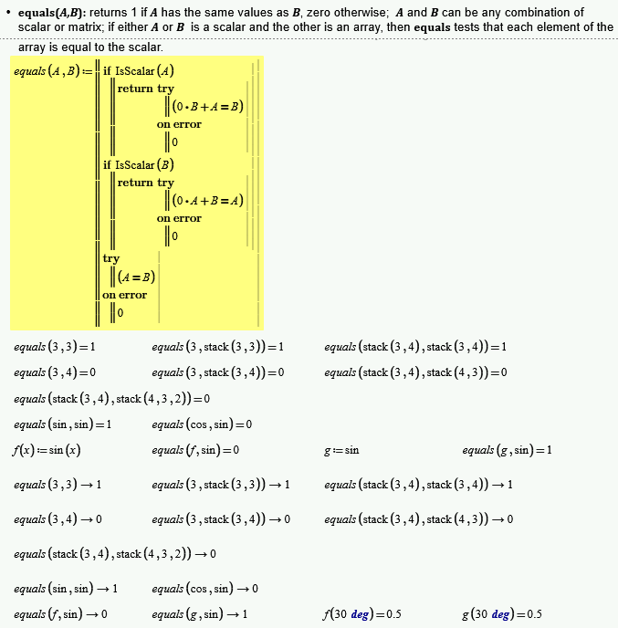

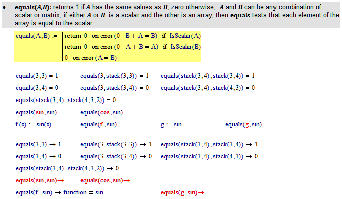

... That's interesting.   I was thinking about using IsFunction in my function equals (used in IsZero above) to see if I could test functional arguments for equality.  Out of idle curiosity, I tried using equals on functions in Prime (I know it doesn't work in M15) and it seems to work, even symbollically.
Prime 3.1
Mathcad 15
Looking at the difference in the physical (if you can call it that) size of the M15 and Prime versions of equals, it is clear that "compact" is not in PTC's vocabulary!
