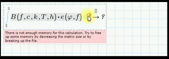

Hello all,
I'm using Mathcad Prime 7.0.0.0 and during calculations I get warning message as in title. I have PC with 16GB RAM and when I monitor task manager Mathcad doesn't reach top border of available memory. There is still about 5GB free RAM. Other components as CPU ect. also doesn't work at full performance...so I don't know where is problem. I know that this topic was touched previously but that answers not fit to my issue. Thank you in advance

Know this isn't helpful but could not resist.
I have PC with 128GB RAM and when I monitor task manager Prime doesn't reach anywhere near top border of available memory.
I know Prime can use 121GB from an earlier post on this forum with a memory intensive posters sample.
The problem is not lack of overall memory.  Perhaps the symbolic engine has an unpublished limit?
I have tried to use a few keywords but have no effect on out of memory message

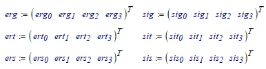

- You defineLucMeekes_0-1643553214046.pngbut you never use it.
- You carry a parameter c as a function argument through several functions. In your definition of e(phi,f), at the point where you call the delta.g, t and s functions you supply them with c, which is predefined in Prime as the speed of light in vacuum. That's a constant, isn't it? I also see h and k which would be h (Planck) and k (Boltzmann). Am I right?
One question: You define a number of constants numerically. Why are you requesting a symbolic solution?
Chances are (high, even) that the symbolic processor chokes on your expressions. They are quite large.

(So this is using:
then
Which symbolically expands to:
Likewise for the other E functions, and for the sigma functions use the sig tables.)
Can you expand that in Prime?
Another example, t.gt(phi,f):
(don't be fooled, this light gray bar just above here contains the expansion, but it's so large...
Here's the first two pages of it:
And can you expand the e(phi,f) function in Prime? I can't.
