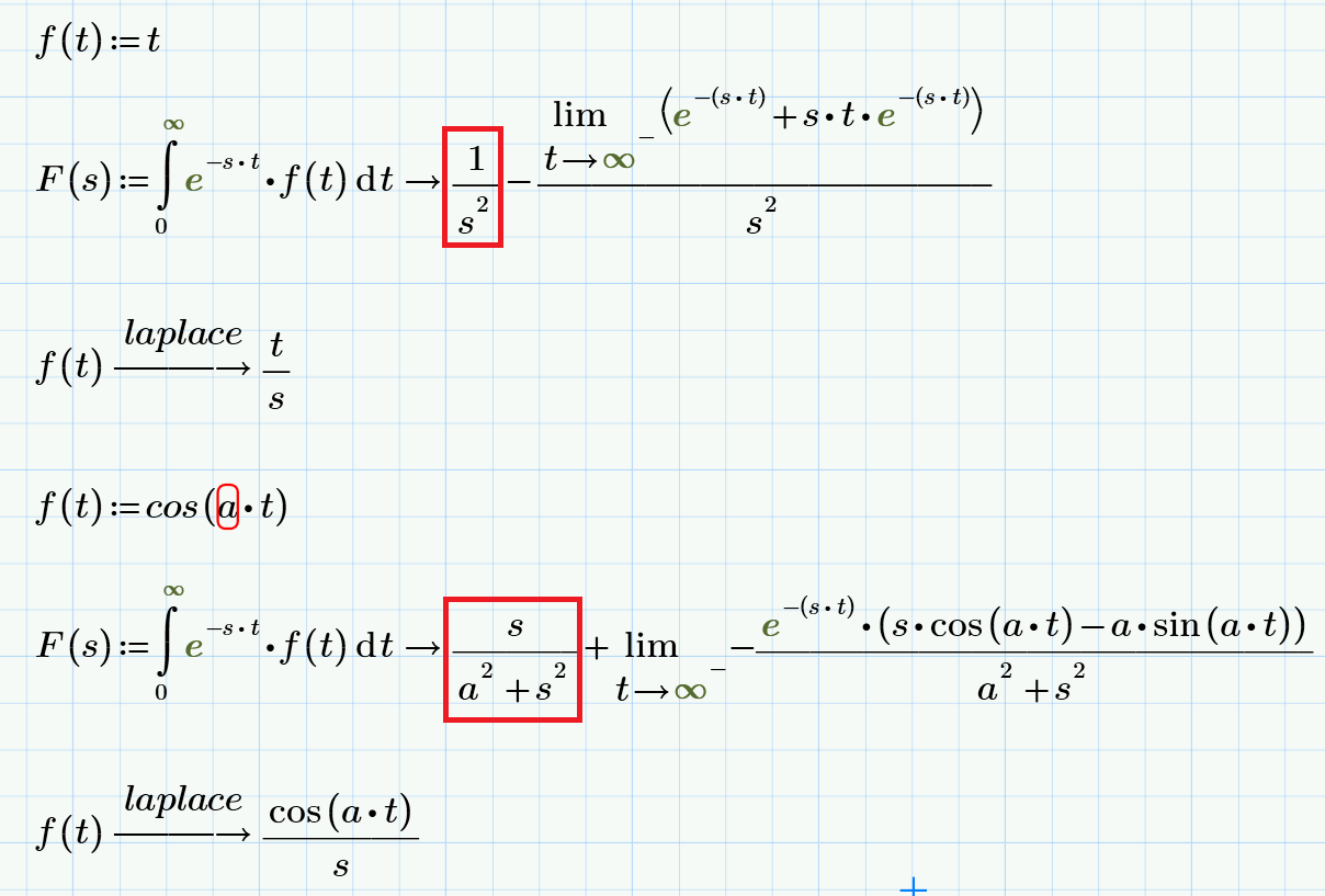

Considering mathcad A very powerful  calculation tool, I can not accept that in calculating the Laplace transform of the square root of t square, + a-squared, I have to resort to the tables. One can not intervene in some way, for example giving the user the possibility to expand the set of transformed?

Hi ! in fact I do not understand what you want me to say.
All I know is that those results are incorrect.
But I have never encountered such problems as you can see in my documents in the "electrical engineering", where I make extensive use of the Laplace transform.

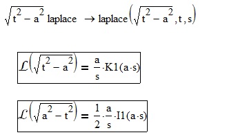

Mathcad 11:
Internet...

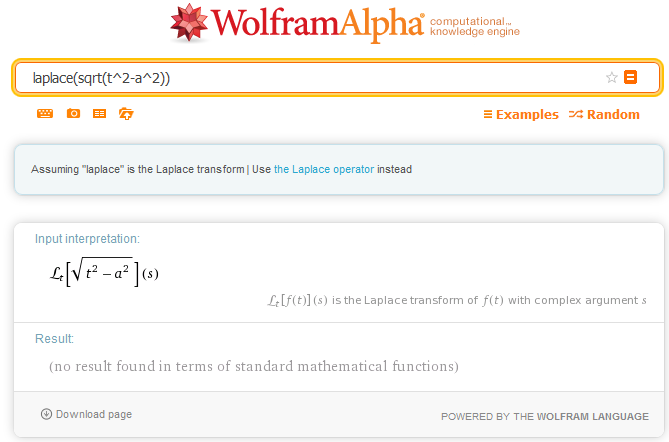

Are you sure your transform is correct?  (Can you prove it...)
December 21, 2015
...And Maple 18.

December 21, 2015
Hi, Viktor Korobov! The correction is right, but not the answer I'm looking for.
