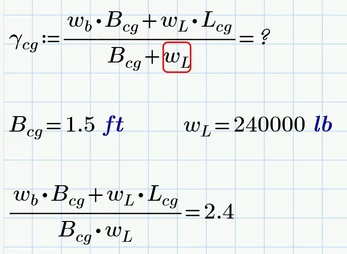

When Prime moans about incompatible units its usually correct. Unit checking is one of the strengths of the program.
In your case "Bcg" is a length/distance, but "wL" is a weight. You sure can't add quantities of different dimensions.
Maybe you meant a product instead of the sum?
Or more likely you wanted to use "wb" instead of "Bcg" !?
Yes, you are correct with the wb. Thank you! I have another one with the same error, but different problem. I'll start a new post.
