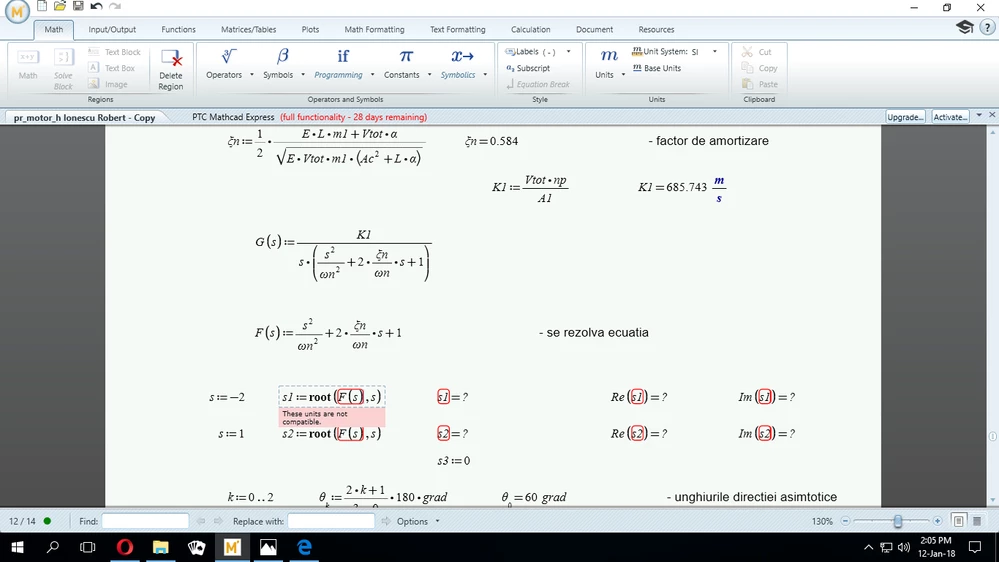

These units are not compatible
23-Emerald V
January 12, 2018
Try, instead of setting s:=-2 (without units), to give the guess value for s the same unit as what you give ohmega.n.

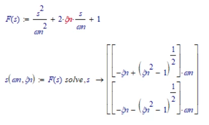

Otherwise, first solve the system symbolically, then fill in the values.
January 12, 2018
We don't see the value of wn.
What you have written should work if wn is unitless.
Otherwise  s and wn must have the same unit and the guess value s:=-2 must have this unit, too.
January 16, 2018
Please attach your Mathcad worksheet in zip archive to the message.
