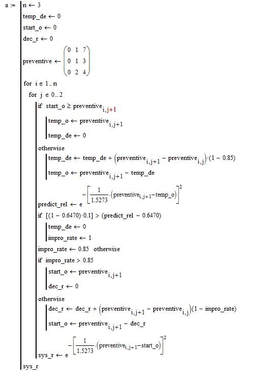

I use mathcad program.

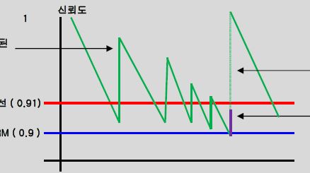

I want to have "sys_r" graph.
I try a below captured programming.
But programming error occurred.
programming error!
Error is "This array index is invalid for this array."
I don't know solution.
Please help me.
graph shape example !

Try please ORIGIN:=1
Mar 9, 2015 8:54 AM UTC
Mathcad counts from 0 by default. Because you set j = 0..2, and you have a 3x3 matrix with elements numbered from 0,0 to 2,2, when j = 2 then j+1 = 3, and there is no element with a j index of 3. Simply setting ORIGIN to 1 (so Mathcad counts from 1 instead of 0) won't cure this as you use both j+1 and j in the routine, so if ORIGIN = 1, you can't have j = 0.
If you correct this, you will have a problem with index i, as this runs from 1 to 3.
Alan

Thanks you.
I clear the error.

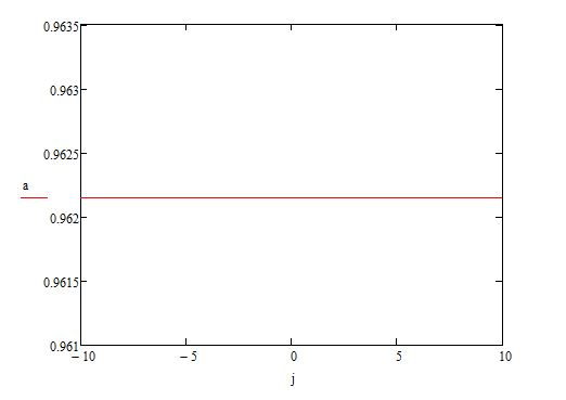

But I don't draw a graph.
Different from the example graph.
I want an example graph
I want to have a hint to draw an example graph.
