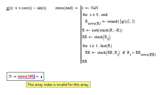

Hello Everyone.
From :
1.PNG2.PNG"This array index is invalid for this array." ?. How to make a correction ?
    Thanks in advance.

This "zeros" is not a built-in Mathcad function; it's probably a user defined function in the sheet you're referencing.  (Many long-time users have hidden regions of utility functions at the top of their template sheets.)

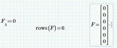

The sequence I showed (defining only the last element) will create an array or matrix full of zeros of that size and does not require a utility function.
23-Emerald I
I don't recognize the function "zeros".
Try this:Capture.PNG

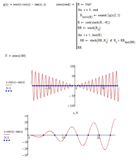

Neither do I. (see "x.cos(x) - sin(x) = 0 solve , x ?" 's post).
    Regards.
