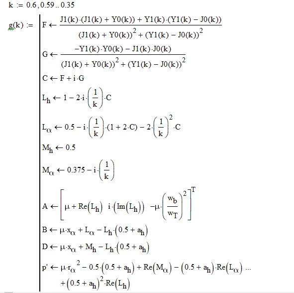

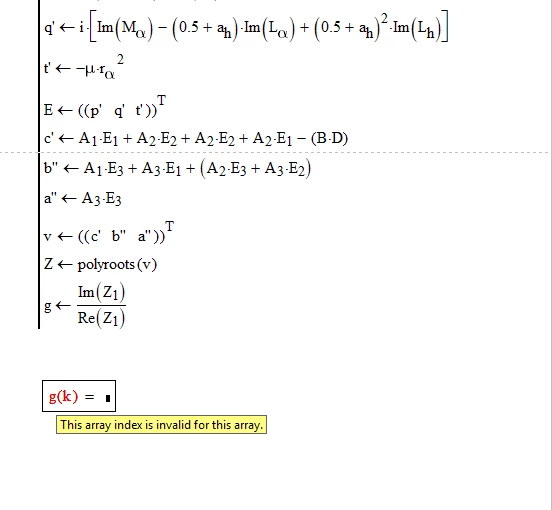

Hi everyone, i have a problem when write a program about aeroelasticity
When i type "subscript letter" by press "." , Mathcad said the letter "A1, A2, A3, E1, E2, E3 "  : "this variable is undefined"
But when i type it by "[", Mathcad said with "g(k)" : this array index is invalid for this array
Please tell me how can I fix the problem? Thanks all !

This my Mathcad file, i hope you can fix it. Thank you very much !

terryhendicott identified the problem correctly.  Simply put ORIGIN:=1 at the beginning of the file.
Alan

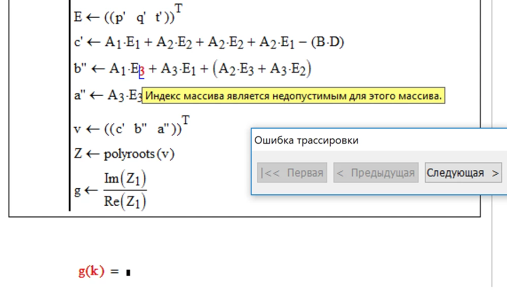

October 3, 2017
The default is zero based arrays unless you set origin to 1.
You have set E as a three element vector and refered to it as E[1, E[2, and E[3 but by default it is E[0,E[1,E[2.
Two solutions, change the code or set ORIGIN:=1 at top of the sheet.
Cheers
October 3, 2017
Click please on the red operatot the right botton of mouse and do Trace Error!
This Index wrong!
