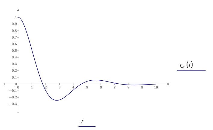

I converted a part of file from my Mathcad 15 worksheet and getting the error due to this i am unable to proceed with calculations Can it be converted somehow?
23-Emerald V
It seems it can't be converted, Prime does not understand the syntax.
You'll have to retype the expression in Prime. I'd suggest you use the middle one:
Then when you try to assign the symbolic result to the iac function, you'll get another error in Prime:
It appears that Mathcad 15 would (implicitly) solve the middle part for iac, you have to tell Prime what to do:
P.S. Note that Iac is NOT a function of Cdc (or is there an error in the expression...?).
