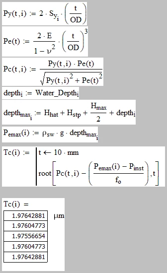

Need help with the root function which i keep getting the error 'This function cannot be used here'.
(mathcad 15)

The function you feed into "root" returns a vector as a result but to make "root" work it has to be a scalar valued function.
Not sure if you get what you are looking for if you turn Py and Pc into functions of t AND i:

Thank you!
