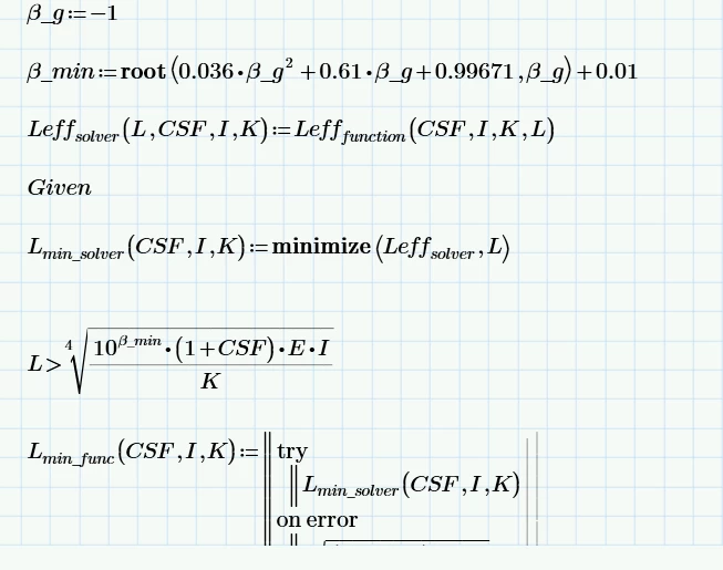

I have a problem in Mathcad. As the picture shown, it always says "This function requires at least 4 arguments but it applied to 1". Can anyone help me? Thank you

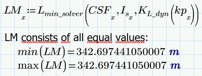

Why should the solution I posted not work now? Just give it a try. I did and the result was pretty much the same - the result vector would consist of all equal values - maybe because the Excel input consists only of one line? Haven't looked into detail how the data vectors are calculated.

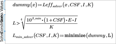

Furthermore the region
has no effect (as does the "Given" which you can delete)!?
In the MC15 file, is this expression actually below the L.min_solver(...):=... line or is it above it (but below "Given") ??
If its between "Given" and "Minimize", then its an additional constraint for the minimizer and you have actually to use a solve block like
I did so in the attached sheet (Prime 9 format), but it did not change any results.

The error message is tied to this:
The definition of Lmin_solver is:
Which means that Lmin_solver has 3 parameters, but none of them are used in its definition. What is used in its definition is Leffsolver, That is not a simple parameter or array, but a function, defined as:
So Leffsolver needs 4 parameters, you use it in minimize, but supply only one parameter: the L. That's not enough.
You need to supply 3 more parameters to the minimize function.

I see that you wrote "Given" in front of the definition of L.min_solver. So I guess you are retyping something which was created in Mathcad (version 15 or below) where "Given" would initiate a solve block. This changed completely in Prime as you would have to insert a solve block via the menu - "Given" is obsolete.
But "minimize" does not require the usage of a solve block anyway and can be used stand-alone if no additional constraints should be applied.
The problem seems to be that on contrary to Mathcad, Prime does not allow for incomplete functions in "minimize".
So I guess that a suitable workaround is using an auxiliary function like shown below
BTW, the sole definition of Leff.solver seems to be the rearrangement of the arguments so that L is the first one. This was done to allow Mathcad to fill in the missing arguments automatically when minimizing just for L. As this does not work in Prime anyway, you could abandon Leff.solver and use Leff.function right away if you like.

Hello Werner, as you might have guessed I retyped something from Mathcad 15 (converter not working).
It looks like I forgot to include some equations, can you please check? Does the solution you mentioned before still work? (The equations I forgot are attached in the picture)
