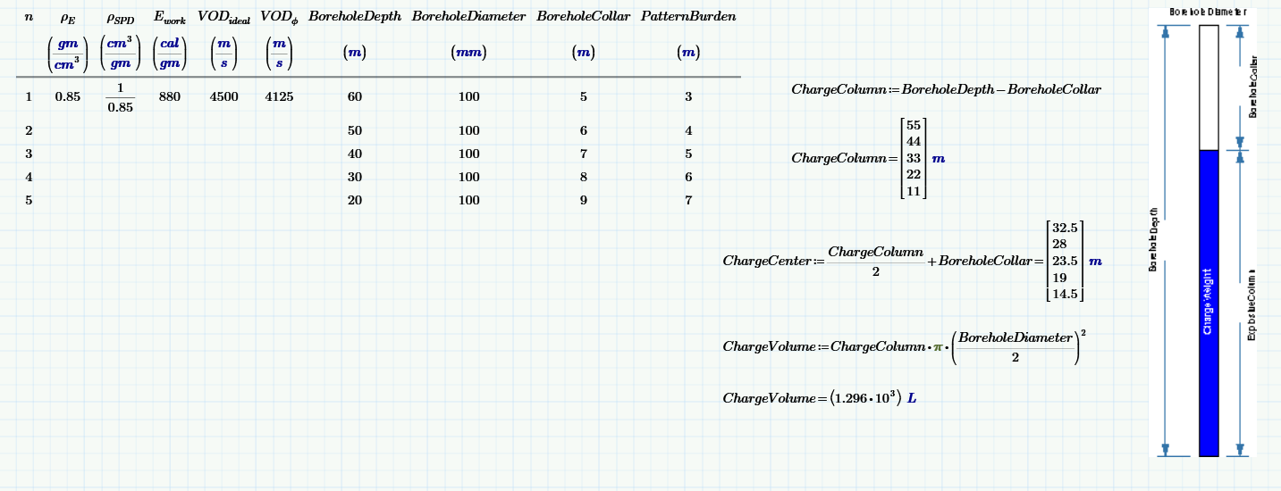

I use tables quite a bit but when I used them as input to calculations, the output does not reflect the number of data points that are supposed to be calculated from the input data.
See example below (only one value for chargeVolume). What the heck is happening or I am brain dead for this simple calculation.
23-Emerald I
November 16, 2016
Typically, when presented with an arithmetic multiply on vectors like this, Mathcad will execute a dot product, resulting in a scalar.
Try "vectorizing" the right hand side.  (select the right hand side, type "Ctrl-Shift-^".  Tells Mathcad to execute element by element.
