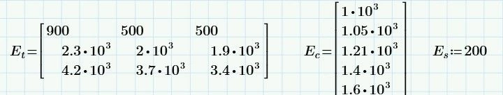

This value must be a function
Having an issue with the solve block, most likely because of my little experience with Mathcad.
I do have a function in the constraints, but don't know how to solve the issue.
Any recommendations will be greatly appreciated.
terryhendicott
One problem that will be encountered is a matrix mismatch. in the last equation.
Poor Prime will be confused.
Cheers
Terry
6 replies
terryhendicott
Cheers
Terry
I see that now, Et utilizes different turbine temperatures for different curves, I'm assuming I'll have to constrain it to one curve at a time, as that is what the compressor has.
