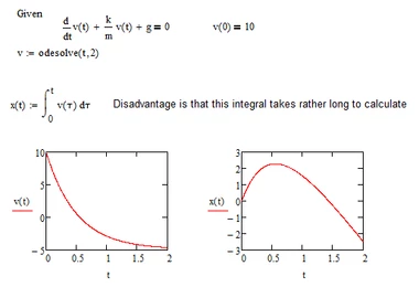

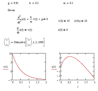

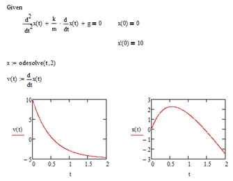

-MFra-

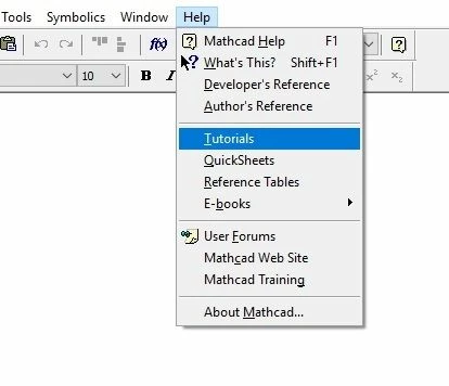

Hi Jonirt,
To learn how to use MATHCAD 15, you should take a look at the tutorial:
Fred showed you your error in setting up the equation and also a nice way to do it without "odesolve".
Here is the correct way to do it in the manner you tried and to other possibilities - all using odesolve (which unfortunately means "no units" in Mathcad 15):
