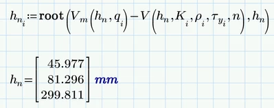

I am getting error this value must be a scalar what is wrong with the worksheet.
6 replies
Sep 11, 2023 8:58 PM UTC
Are you really expecting h.n to be a 3 x 3 matrix with a total of 9 values?
I guess you just want it to be a 3 x 1 matrix( vector), correct?

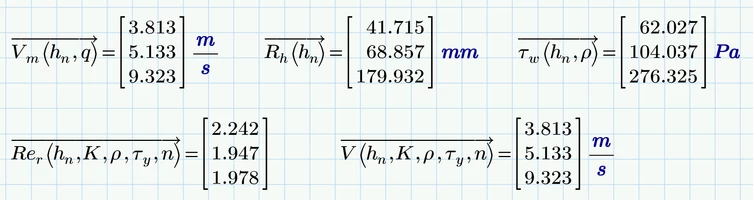

So you should do it that way (no need for the range j):
For the subsequent calculations I would not use the range variable(s) but rather use the vectors as function arguments and use vectorization (the arrow over the expression):
Modified Prime 9 sheet attached

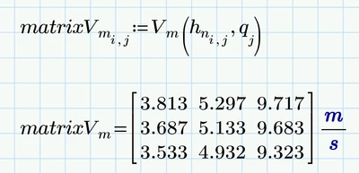

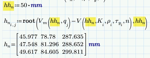

Sep 11, 2023 9:28 PM UTC
After looking closer in your sheet I guess now, that you actually wanted hn to be a 3x3 matrix, covering all combinations of the three TQ values and the three LCp percentages.
To make it work you have to name the guess value differently from the result matrix, e.g.
Don't display the matrix using the ranges i, and j as it will look like a vector if you do so
Similar for the other subsequent calculations
Instead of displaying
you may rather assign the function result to a variable and display it
6-Contributor
Sep 12, 2023 2:50 PM UTC
Thank you Werner for the help. In here why  it is necessary to have hhn instead of hn also, the result output hnij how do I get 1 4 and 7 value as 1 2 and 3 value the hierarchy is mismatching any suggestions
