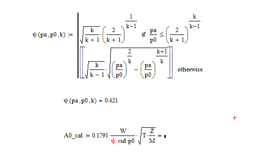

I'm trying to create a simple programming sheet but I cant solve this error "This Value must be a scalar".
MJGAnswer
Either define ψ as a variable instead of a function, or call the function arguments in A0_cal:
Option 1:
Option 2:
MJG1-VisitorAnswer
Option 1:
Option 2:
