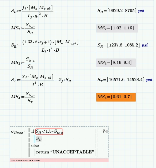

"This value must be a scalar"
Hi all,
How can change this figur to be a scalar

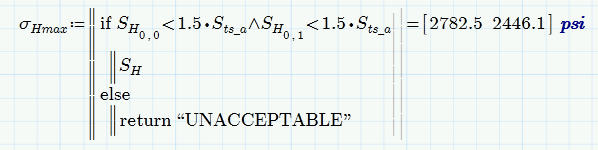

So then perhaps what you want is something like this?

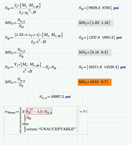

November 14, 2014
We don't see the definition of S.ts_a.
The variables you show seem to be 1 x 2 matrices. I am not sure if you have created them that way on purpose or accidentially have used the square brackets.
If your variables are matrices consisting of two values on purpose, you will have to decide which of those two values you want to compare against S.ts_a (I suppose this will be a scalar).
For further questions please additionally attach your worksheet.

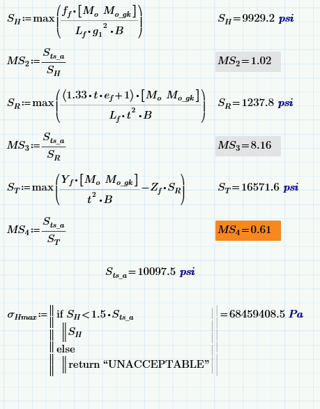

November 14, 2014
Because the units are not compatible
November 14, 2014
But, it does work without the matrix (units are still the same)
