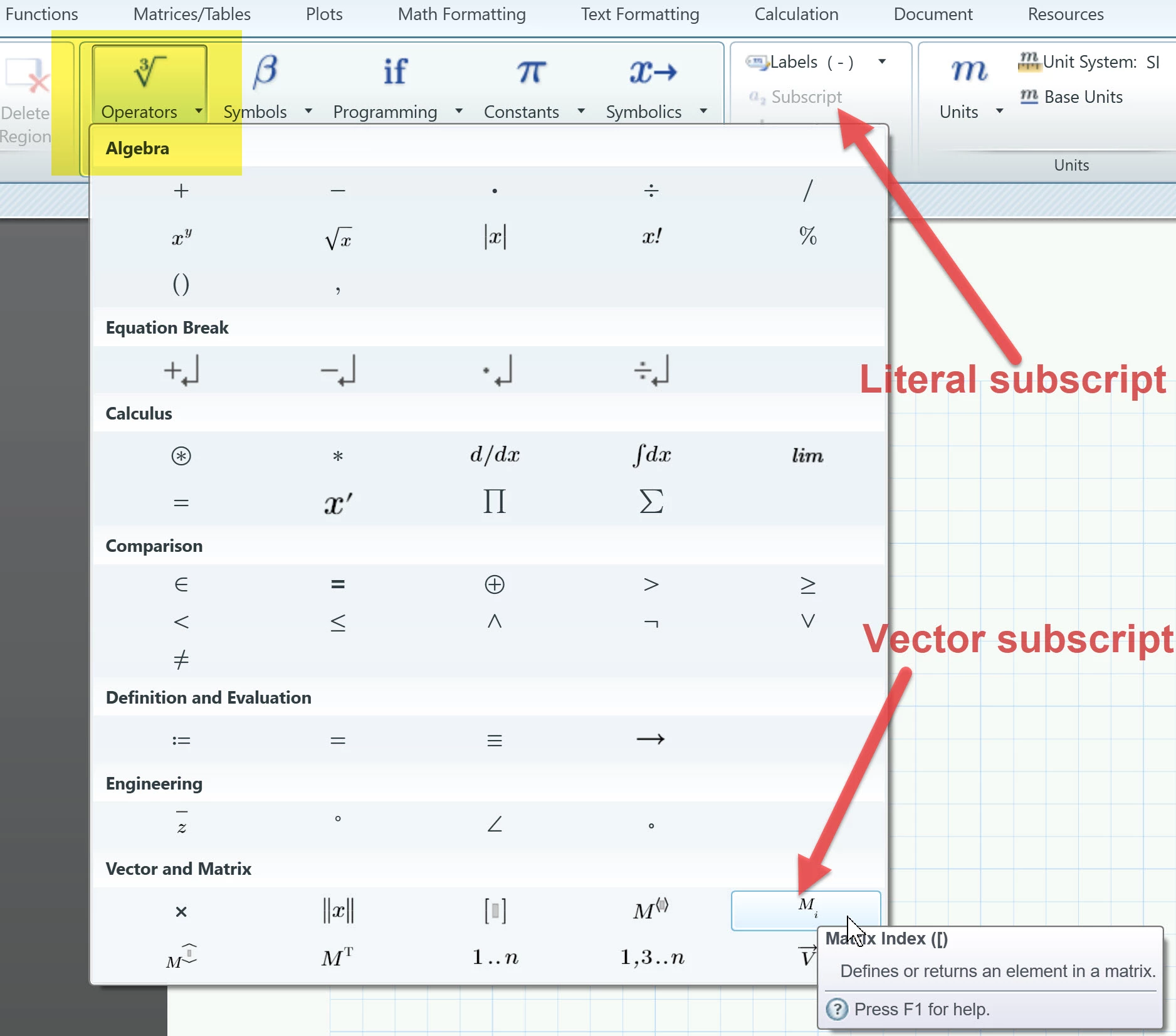

The subscript i is a vector/matrix subscript. This is different from the literal subscript you get by typing "Ctrl -".
You get the vector subscript by typing "[".
You can also use the menus:

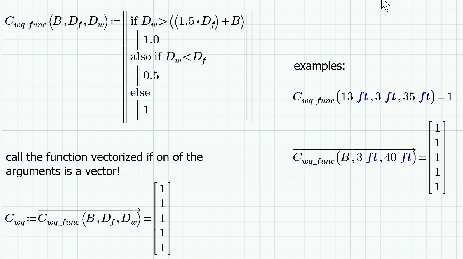

When you defined your table, you have defined B and the other 3 variables as vectors.
In your first failing calculation you used a comparison operator (<). You can only compare scalars, not vectors. Thats the reason for the error.
One way out would be to turn all calculations into function which are dependent by the for input variables B,L,D.f and D.w.
The variables have not to be defined before.
You can now define the variables and call this functions. If one of the variables is a vector, you have to vectorize (the arrow over the expression) that function call and Prime will feed the vector values singly into the function and returns a vector of the results.
I have done that here with the first calc which failed.

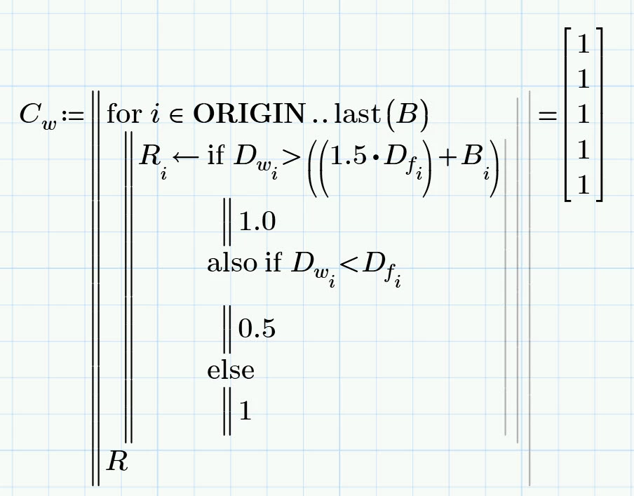

Less preferred (in my opinion) is a solution which uses a little program which runs via a for loop through all the values in your vectors:
idahoan12-AmethystAuthor
thank you.  in your last solution, what are the steps to initializing the variables within the program, i.e., placing the sub-subscript i?
